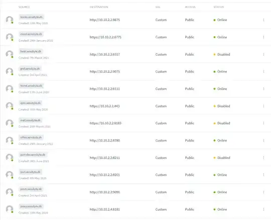

Live example
Just to give you an idea about how some of my web services are set up:
