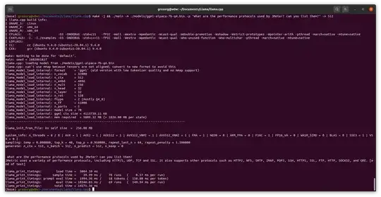

  1. Update path + Run (question) prompts from terminal
/Documents/Llama/llama.cpp$
make -j && ./main -m ./models/ggml-alpaca-7b-q4.bin -p "What is the best gift for my wife?" -n 512
Result:
How terminal command looks like
Source: https://github.com/ggerganov/llama.cpp
