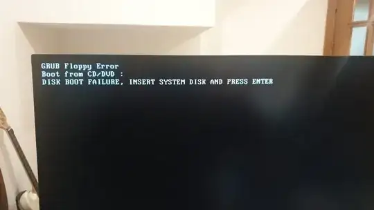

I'm running Kubuntu. When I try to boot from the live USB to reinstall latest Kubuntu 22.04, I get this error, even though I haven't got a floppy disk on this PC.
Grub floppy error

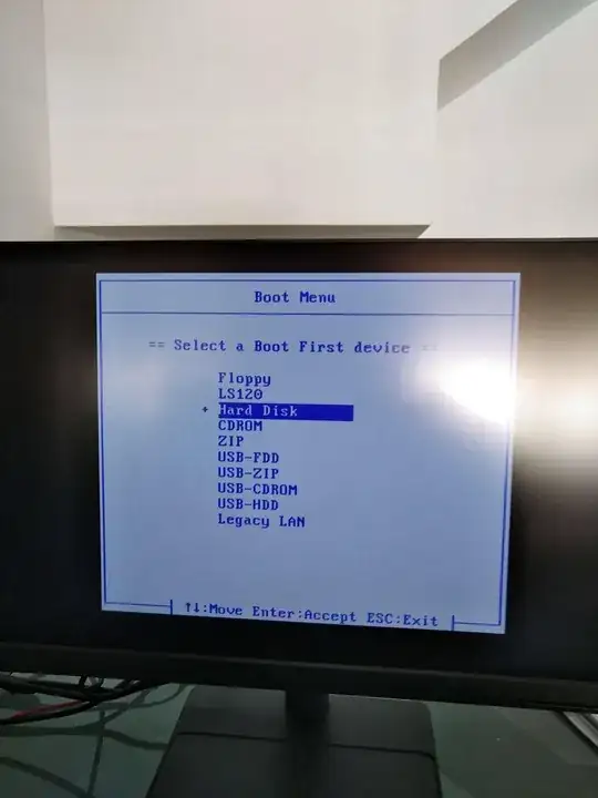

This is the boot menu.
I don't know which of these option to choose to boot from the live USB.

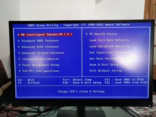

Ok , I managed to reinstall Kubuntu wiping everything. I had to go into bios, change the first device to boot to USB-ZIP. First try the live Usb in a different PC to make sure it worked, since the first one was causing Floppy GRUB error.
