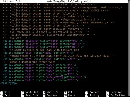

One word in the policy.xml needs to be edited in order to give permissions for ImageMagick to convert pdf files to images. ImageMagick also does batch image format conversion (see the example command at the end of this answer). If a pdf file contains multiple pages with images it is convenient to export the pages as single page PDF documents using the PDF Arranger app (sudo apt install pdfarranger) which also identifies each page of the output by including its original page number in its new file name.
  1. Edit the policy.xml file /etc/ImageMagick-6/ in the terminal by running this command:
    sudo nano /etc/ImageMagick-6/policy.xml
  2. Scroll down to the bottom of the file by pressing the down arrow key. Find the line that says <policy domain="coder" rights="none" pattern="PDF" /> replace none with read|write as shown in the below screenshot in the second to last line.
    Nano text editor keyboard shortcuts
    Use the keyboard combination Ctrl + O and after that press Enter to save the file to its current location.
    Use the keyboard combination Ctrl + X to exit nano.
