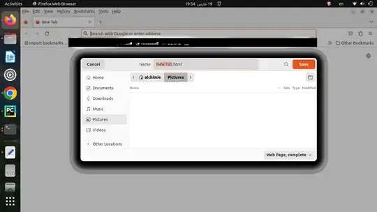

Just noticed this issue on Ubuntu 23.04 shipped Firefox (snap) too. Seems like this bug is still not solved.
What's actually happening is, even though Ctrl+S is pressed only once, for some reason it triggers the "Save Webpage" functionality multiple times. Thus, multiple dialog boxes are opened, one on top of the other. That's why the window shadow looks like a back halo around the window.
To close all of them without closing Firefox, simply click the dialog box to put focus on it, and press and hold the Esc key until all dialog boxes are destroyed.
Or alternatively, you could continuously click the Cancel button in the top-left corner of the dialog box until all of them are destroyed. Note: If you only click the Cancel button once, it does close the top-most visible dialog box, but it looks like nothing happened because there are so many dialog boxes open below it in the same position and size.
