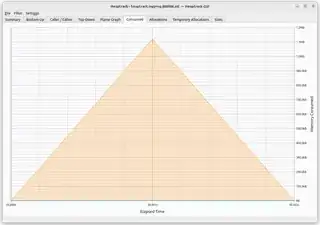

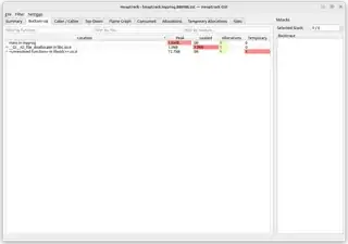

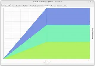

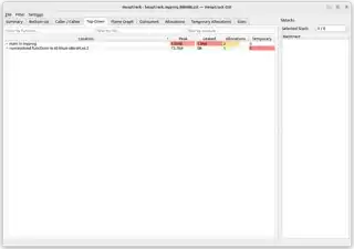

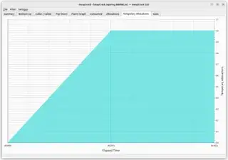

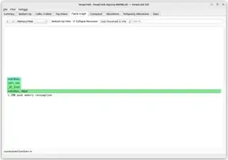

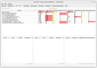

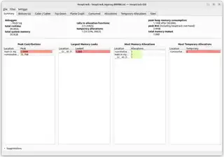

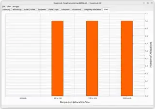

It's worth noting that there is also a GUI heaptrack data analyzer heaptrack_gui which you can, as well, install from the official Ubuntu repositories like so:
sudo apt install heaptrack-gui
Then, use it like so:
$ heaptrack_gui heaptrack.myprog.886986.zst
Heaptrack summary screen "Bottom-Up" screen "Caller/Callee" screen "Top-Down" screen "Flame Graph" screen "Consumed" screen "Allocations" screen "Temporary Allocations" screen "Sizes" screen
