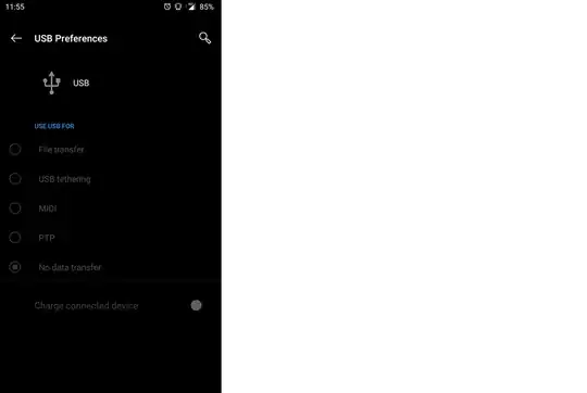

  2. (Step 1): On the Pixel 2 phone:
    (IMPORTANT: do NOT activate USB tethering, or else Ubuntu will not recognize the phone: USB tethering MUST BE OFF).
    a. Connect your phone via USB to the computer.
    b. Swipe down from the top of the phone screen.
    c. Go to USB Preferences and activate the uppermost option File transfer (and not even USB tethering, as mentioned above!)
