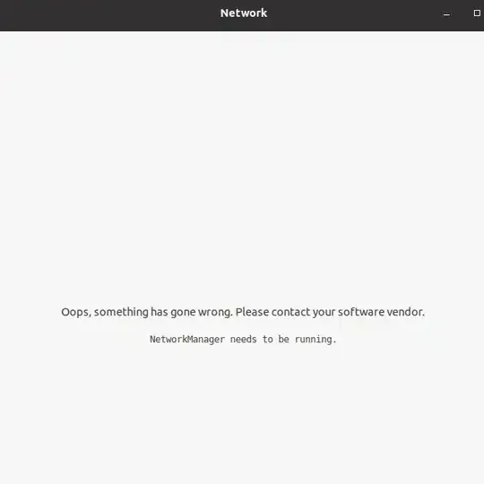

As a new "symptom" I also got this message:
Most often this happens due to the enabled power saving mode (powersave) for the Wi-Fi adapter.
To disable powersave mode, run in the console:
iwconfig wlan0 power off
Where wlan0 is the name of the adapter. You can find out the name of the adapter using the ifconfig command.
