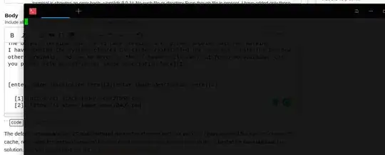

The default terminal and the VS code Terminal are neither showing path nor working. I have updated the system, cleared the cache, reinstalled the terminal, installed the new other terminals, and saw no error in the ~/.bashrc file even but found no solution. can you please help me out?

For me non of the proposed solution work on Ubuntu 22.04. So after searching, I commented this line of code in .bashrc file located at home/{profile_name}
#source <(ng completion script)
