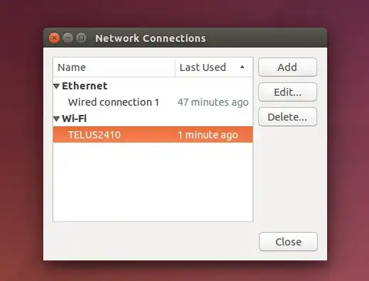

Like the title says, every time I reboot my system, I need to open the terminal and type the following command to get the internet working:
sudo dhclient
I'm new to this so if there is information you need let me know. Here's what I know:
  • I have the ethernet plugged in.
  • It doesn't light up until I input the command above.
  • If I go into the network settings, it doesn't recognize the connection like in the image you see below:
    functioning network connections tab
There is nothing there.
Any help would be appreiciated!
