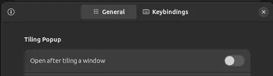

The window switcher popup appears to be opened by the "Gnome extension Tiling Assistant" which you have installed ... So, either disable/remove Tiling Assistant altogether or go to its options and disable Tiling Popup-->Open after tiling a window:

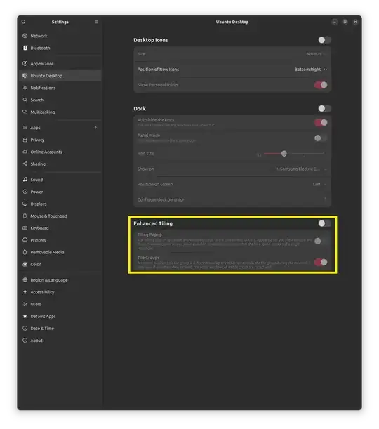

Should you get to this question after the update to ubuntu 23.10. In 'Settings' under 'Ubuntu Desktop' there is a 'Enhanced Tiling' option that can be switched off: enter image description here
For completeness, here's how to do it from the command line:
gnome-extensions disable tiling-assistant@ubuntu.com
On Ubuntu 24.04 at least, tiling will then be handled by Mutter, which doesn't have that feature.
Mutter's edge-tiling feature should be enabled by default, however if by any chance it turns out to be disabled:
dconf write /org/gnome/mutter/edge-tiling true
