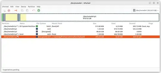

I had a LUKS-encrypted Ubuntu 20.04 setup. I followed my own instructions here to shrink the LUKS partition and install Ubuntu 22.04, also LUKS-encrypted. Now, my grub boot menu no longer gives me the option to boot my old LUKS-encrypted Ubuntu 20.04 version. Rather, it just boots the new 22.04 one.
How do I add the LUKS-encrypted Ubuntu 20.04 version back in?
Here's my disk, as shown in gparted while logged into the new Ubuntu 22.04 OS.
Description:
  1. /dev/nvme0n1p1 is the 512 MiB EFI partition
  2. /dev/nvme0n1p2 is the ext4 /boot non-encrypted partition for the old Ubuntu 20.04 OS
  3. /dev/nvme0n1p3 is the LUKS-encrypted partition containing a single LVM volume with Ubuntu 20.04 in it (no longer in the grub menu)
  4. /dev/nvme0n1p4 is the ext4 /boot non-encrypted partition for the new Ubuntu 22.04 OS
  5. /dev/nvme0n1p5 is the LUKS-encrypted partition containing a single LVM volume with Ubuntu 22.04 in it (is in the grub menu, and is the OS running right now)
Possibly useful:
  1. For more-experienced people, this answer to a different question may have some clues, but I don't understand it: How to get grub to boot from a newly encrypted partition
  2. How to repair /boot on LUKS encrypted harddrive?

After a lot of effort and investigation, I figured it out!
1. How to add other LUKS-encrypted Linux distributions back to your Grub bootloader startup menu
Quick summary
# 0. Install dependencies
sudo apt update
sudo apt install lvm2
1. Open your /etc/default/grub file.
sudo gedit /etc/default/grub
Then manually add these lines to the bottom of that file:
(required)
GRUB_DISABLE_OS_PROBER=false
(optional)
GRUB_ENABLE_CRYPTODISK=y
2. Unlock your LUKS-encrypted partitions which contain other bootable
operating systems. In my case:
sudo cryptsetup luksOpen /dev/nvme0n1p3 nvme0n1p3_crypt
3. Update your Grub bootloader in your /boot partition.
sudo update-grub
When I run update-grub, my output now includes this line:
Found Ubuntu 20.04.5 LTS (20.04) on /dev/mapper/system-root
4. Done. Reboot to see and use the new Grub entries!
reboot
