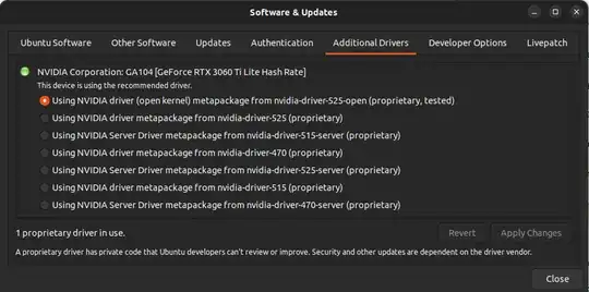

I'm also using Ubuntu 22.04 and experienced the same problem. After some digging around, I found that source of the problem is probably nvidia drivers, so I launched Software & Updates -> Additional Drivers.
Software & Updates
And I changed the driver from nvidia-driver-525 (proprietary) to nvidia-driver-525-open (proprietary).
This reinstalled the driver, and after rebooting the problem disappeared.
