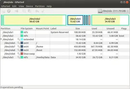

If I look in my partition table, /dev/sda2 is C:\ of the Windows installation, and /dev/sda1 is the "System Reserved" partition (which, IIRC, is Windows' own bootloader). Furthermore, gparted shows /dev/sda2 - but no other partitions - with a boot flag:
What is going on here? I'd like to have only the entries for Ubuntu and one entry for Windows in my boot menu - how do I remove one of them?

You are correct that Windows 7 puts it's "boot" partition on /dev/sda1 by default, but it is possible to get Win 7 to put the everything on its "root" partition too -- e.g. by installing to a pre-formatted NTFS partition.
Perhaps you have tweaked Windows in the past such that the bootloader/bootable flag went on /dev/sda2? Can you successfully boot from both Windows entries? If so, it's safe to delete one of them.
