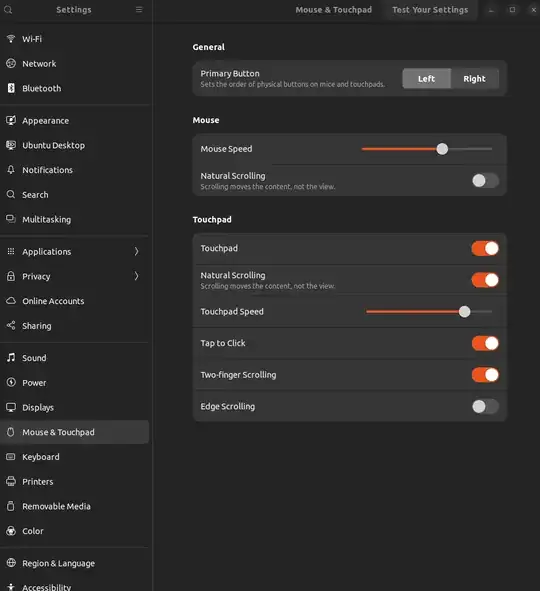

In setting mouse and touchpad, general, primary button, select left.
Ubuntu 22.04
