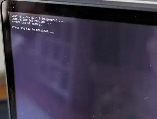

I had the same problem after updating to kernel 5.15.0-67, ignored it for a while because I could still boot with 5.15.0-60, but when I got another kernel update which installed 5.15.0-69, for some reason 5.15.0-60 couldn't boot anymore either, so my laptop was bricked and I had to fix it from an Ubuntu Live USB stick. Unfortunately boot-repair did not work for me, when I ran it from a Ubuntu Live USB stick, it did not have any "suggested repairs".
Screenshot of the issue
From reading this bug tracker comment, I believe this is the explanation for the "out of memory" error:
Grub attempts to read the initrd into a memory location that is too small.
This issue is caused by a combination of several factors:
  • Grub not setting aside enough space for the initrd in memory and not at the right location,
  • Initrds having grown due to holding more modules and more firmware. This is especially the case with the nvidia proprietary driver.
  • Typical screen resolutions and their associated buffers in memory having increased.
Note that the comment linked above also provides some ideas for workarounds. I will provide a full summary of the steps that fixed it for me in the hope this is useful for someone else.
The solution was found by piecing together several other Stack Overflow answers which are referenced in every step.

Which initramfs.conf change actually fixes it?
On the Ubuntu bug tracker, #1970402, the reporter mentions:
After upgrading to 22.04 system is unbootable because of "out of memory" error when loading initial ramdisk. I was able to fix it by editing /etc/initramfs-tools/initramfs.conf and changing configuration to:
MODULES=dep
COMPRESS=xz
RUNSIZE=15%
Not sure which one helped, but I can test it if needed.
Well, I tested, and these are the results in my case:
  • Setting MODULES=dep (instead of default MODULES=most) fixes the issue
  • Setting COMPRESS=xz (instead of default COMPRESS=zstd) fixes the issue
  • Setting both MODULES=dep and COMPRESS=xz fixes the issue
  • Setting RUNSIZE=20% (instead of default RUNSIZE=10%) does not fix the issue
