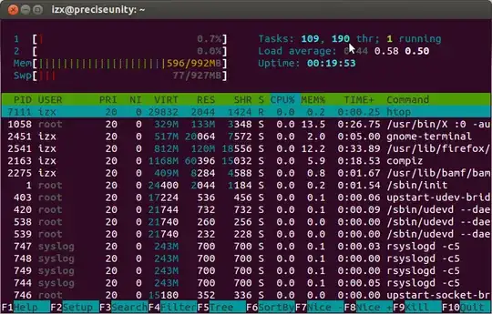

  1. Before:

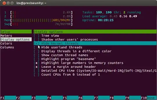

  2. Uncheck the Hide kernel threads setting, press Esc to leave screen instead of F10.

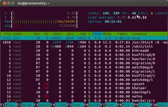

  3. Notice the new number of kthr (kthreads) at the cursor, and all the new k... processes that have shown up. You can sort these by CPU, etc. as usual. Apart from the name (begins with a k, has a / towards the end), you can also identify kernel threads by their very low PIDs (notice the 1, 2, 3...17 in the screenshot?)
