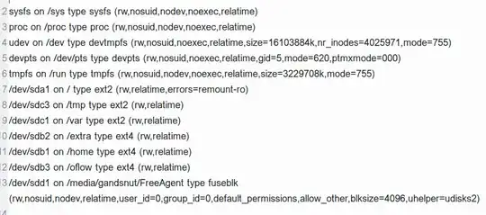

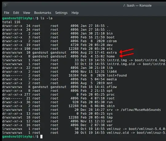

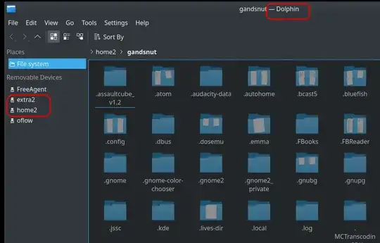

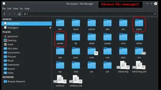

Regarding 20.04, KDE Plasma. Subdirectories in question are '/extra' and '/home'. Both are mounted on their own partitions.
Perhaps 3 years ago, I installed a new hard disk, and during that installation, I appear to have used '/extra2' and '/home2' to copy from source to destination (the new HD).
Why do certain file-operation windows show what appears is the true system names for said locations, and other file-operation windows show '/extra2' or '/home2'? These names work fine, but I'd like to get to the bottom of this.
Ok, I understand what's going on, seeing 'extra2' and 'home2'. @mook765's suggestion about 'lsblk -f' helps alot. Those are PARTITION LABELS, which I believe are optional and can be designated when creating the partitions. I thought they were phantom disk mount points, or something such. Why Dolphin chooses to display them as a 'bookmark' I don't know. This is not a problem, so, nothing to chase. Appreciated the assistance.
