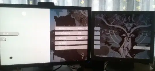

When I run Amnesia: Dark Descent or Superbrothers: Sword & Sworcery, the games are stretched across both my monitors, like this:
Limbo crashes on start-up:
How can I solve these problems?

These are SDL games, and like all SDL games, they will act strangely if you have two monitors. To run them on only the primary display:
SDL_VIDEO_FULLSCREEN_DISPLAY=0 /opt/amnesia/Launcher.bin64 - note this will probably be called "Launcher.bin32" or similar on 32-bit systems.
SDL_VIDEO_FULLSCREEN_DISPLAY=0 /opt/swordandsworcery/run.sh
I didn't need to do any further tweaking with these and they seem to work perfectly.
NOTE: To apply this tweak to all SDL games such that they can be run this way from the dash, just add
to /etc/environment on a new line and then reboot.
