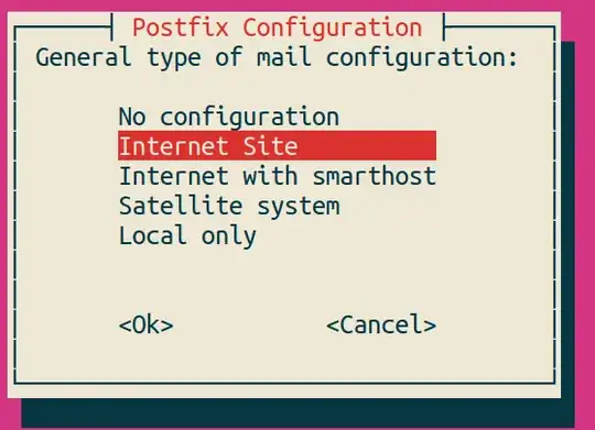

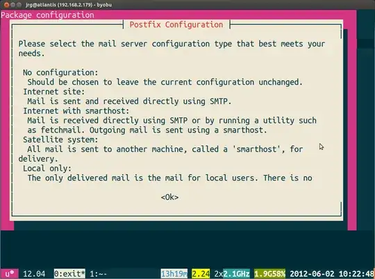

It will go through, and ask you about what mail server you want to use:
Pick one based upon your needs.
It will then ask you about the domain name you want to have email sent from. Again, fill that out based upon your needs.

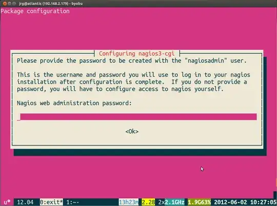

It will ask you what password you want to use - put in a secure password. This is for the admin account nagiosadmin.
And then you'll need to verify your password.

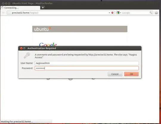

Once the install is all done, you can head over to localhost/nagios3 (or whatever the IP address/domain name of the server you installed it on is) and you'll be asked to enter your password:

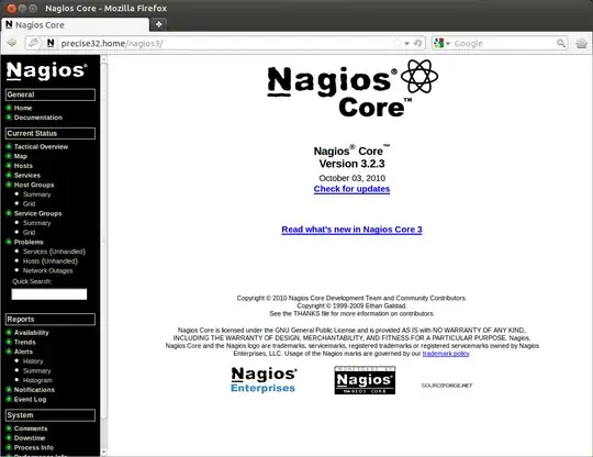

Once you've done that, you're in!

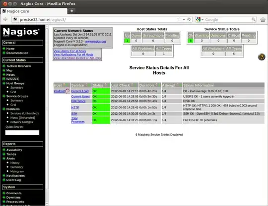

Little ugly, huh?
Nagios automatically adds in the 'localhost' to the config, and does load, current users, disk space, http and ssh checks.
