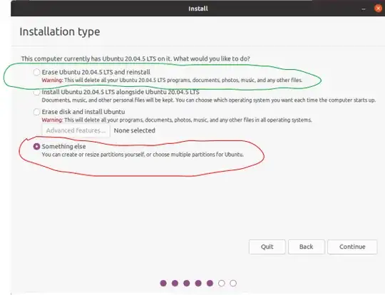

  2. In doing the live USB 20.04.5 reinstall, I used the Something else option shown circled-red in this attached screenshot. I didn't use the green-circle option because it clearly warns that all docs and programs would be erased.
    Install option screenshot here
    Googling suggested to use the Something else option in the screenshot link above and that it would save my docs and programs: https://ubuntuforums.org/showthread.php?t=2456393, hence I did the same. I did not format the drives during the reinstall, but that instruction is a bit different from Ubuntu's official documentation, though its screenshot shows old 14.04LTS and the upgrade/install option there says files will be kept (in contrast to the 20.04.5 installer). It seems different versions behave differently in this regard from what I've seen googling and the answers are not consistent. https://help.ubuntu.com/community/UbuntuReinstallation

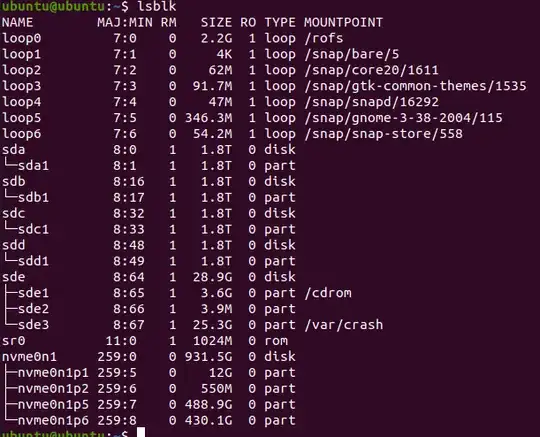

  3. When I used the “Something else” above, when prompted, I mounted my nvme0n1p5 partition containing my existing Ubuntu as / and another nvme0n1p6 partition containing my old home as /home. The installer self-identified the /swap partition (nvme0n1p1) and I didn't have to manually select it for mounting. I also have a 4-drive 8TB software raid5 array, but didn't mount it during the reinstall. Here is the terminal output of lsblk run from the live USB when "trying Ubuntu":
    lsblk output here.
