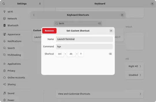

1. Shortcut key
It seems so easy if you know the command. You will open Settings > Keyboard > View and Customize Shortcuts in Keyboard Shortcuts section, then you will search for Terminal and replace the command.
After months of searching the internet and failing to find the command, I finally could find it out on the package file list: kgx – That’s it!
Terminal Keyboard Shortcut
Next time you press Ctrl+Alt+T, it will open GNOME Console for you.
