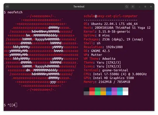

The terminal on schule is extremely weird:
  • it doesn't show the directory you're in
  • it doesn't show username@computername
  • when you paste commands they instantly execute (except sudo commands)
  • if you try to use ARROW_UP to get your last command back, it instead puts ^[[A in the console.
  • if you try to use ARROW_DOWN to go down in your command history, it instead puts ^[[B in the console
  • it is just a blank $ and then nothing afterwards
Tried some stuff, including resetting the .bashrc file, or copying the contents of dom's bashrc into schule's bashrc but nothing worked. Here is how it looks when you try to type a command, and then use arrow up: enter image description here
I even tried creating another user, named "test" but the terminal also acts weird on there. The terminal is completely fine on dom. Does anybody know how to fix this?

The default shell given to a new user is sh not bash which is the default shell on Ubuntu ... I would delete the user and recreate using
sudo deluser --remove-home  schule  #  delete user
sudo useradd -m -s /bin/bash schule # create user and give bash
New user will have a file ~/.bashrc .... to give a nice terminal prompt which shows the current dir add following to the bottom of the user's ~/.bashrc file
PS1='${debian_chroot:+($debian_chroot)}\[\033[01;32m\]\u@\h\[\033[00m\] \[\033[01;34m\]\w\[\033[00m\] \$ '
