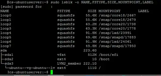

I have an Ubuntu server that stopped working this morning. I logged in and found out that it was out of disk space.
Results of lsblk :
ubuntu partitions
Free space left:
free space left
I can see that the root partition is 100% full, and that's why the server stopped working, however I don't understand why my ex-sysadmin made a partition of 111GB when the drive had 223.6GB of total disk space.
What's the best thing I can do now? Is there any way to increase the space of the actual partition in a safe way without causing any damage to the files inside or the file-system?

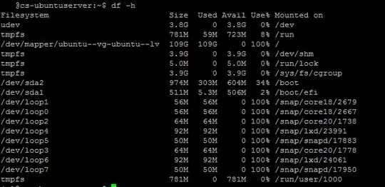

Results of df -h :

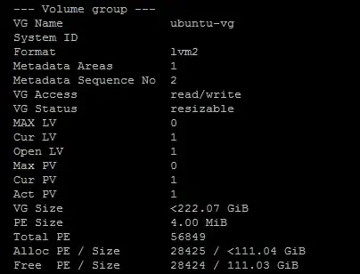

Results of vgdisplay :
vgdisplay
I can see that there is 111GB free space on the drive. How can I add it to the existing partition?
