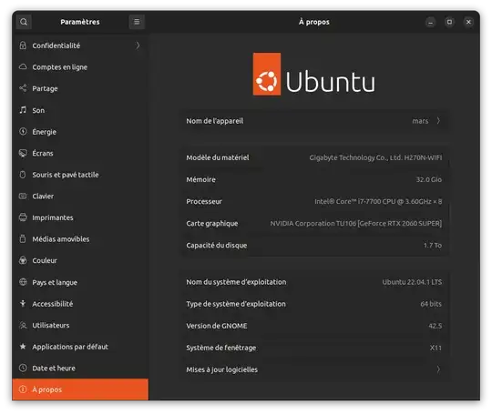

My configuration (yes I am using Ubuntu 22.04):

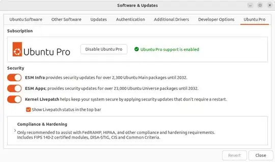

I have found the solution. Run:
sudo pro enable esm-apps
and then update using the usual way and imagemagick and all related packages will be updated.
If Ubuntu Pro support is enabled on your Ubuntu Desktop, you can go to Software & Updates and open the Ubuntu Pro tab.
Software & Updates
In this context, it should be noted that "ESM Apps" cover applications from the universe repository.
Note that it is necessary to have an account on ubuntu.com and this feature is free for up to 5 machines.
See the Q&A about Ubuntu Pro.
