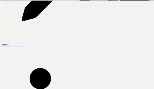

I am having the following issue: I open Teams, go to the Calendar icon, and then click on the "New Meeting" button located in the top right hand corner. A pop-up window appears, like so: enter image description here
This to me looks like the it is zoomed in uncontrollably. However, I cannot get it to open normally. I raised a ticket with Microsoft, they called me back and one of their "engineers" had remote access to my machine to "diagnose" the cause. He advised me to purge Teams from my system, including cache and config files and reinstall it. I advise him that I had already done this, twice, but he insisted we do it again, so we did... and still no change.

I reinstalled the Debian package that I downloaded directly from the Microsoft Website. It all works absolutely fine, apart from the issue with the New Meeting button presenting me with the window as shown in the image. I can add a title and hit return, but nothing happens. CTRL+ and CTRL mouse scroll etc. do very little, I just see enlarged icons.

My teams client has the config in a different location. Try removing ~/.config/Microsoft/Microsoft Teams/
rm -R ~/.config/Microsoft/Microsoft\ Teams/
This fix removes all your config, so you will need to reset any preferences, as well as log back in. It appears to be temporary, something trips up and the 'Add Meeting' will have the zoomed in view again.
I think this is better than forcing you to a Browser client or telling you MS doesn't support it.
For me, first changing Teams setting for GPU acceleration (I disabled it as it seems that it could cause the issue), and then:
sudo killall teams
Then started Teams again and logged back in. It fixed the issue. GPU acceleration setting is preserved during these steps as it's obviously saved elsewhere.
