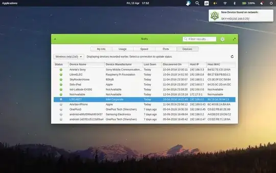

Edit 3: There is already a tool called Nutty that can do this, but last release was 2019.
screenshot
