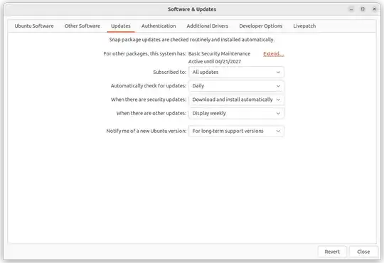

A few screenshots:

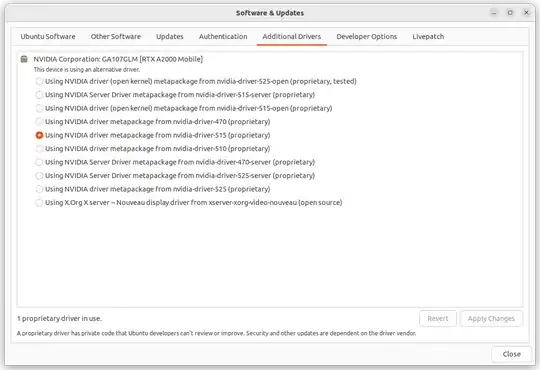

My currently-selected driver which I just chose after this last time of the manually-installed one getting undone by Ubuntu after my last reboot:
This driver seems to work okay since its version matches the manually-installed one I had previously installed. 5.15 works. 5.25 with the open kernel does not--it fails to work with external monitors (nothing displays), and it puts the laptop screen at full brightness and won't let me dim the screen.

This is not really an answer; it's a lame work-around:
I chose the 5.15 option provided by Ubuntu, and rebooted, and it seems to work just fine
