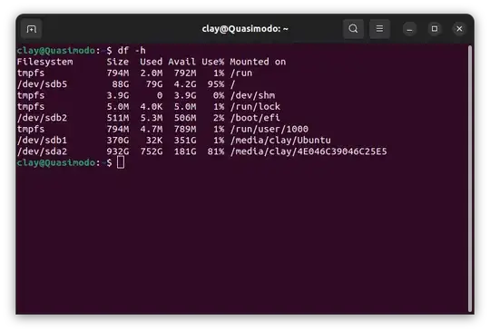

I wanted to run Ubuntu on my primary system so I installed a second hard drive, a 500GB. I let the install program do all of the partitioning. I tried to move files off of my Windows 7 drive, but I ran out of space. I went to this website as it seems to be the same thing that my system is doing. I typed df -h into terminal and I got this:
Screenshot1

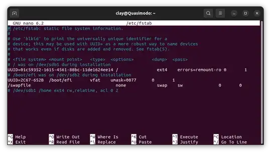

In nano as root I edited the /etc/fstab file and added this line:
/dev/sdb1  /home  ext4  rw,relatime,acl  0  2
I saved it and then restarted. This made my /home directory inaccessible and locked up my computer. After a few tries trying to gain access to /home, I went back in and added # to the beginning of that line and was able gain access to /home again. I used terminal to make the directory Docs in /media/clay/Ubuntu. I can access it, but can't do anything else with it. It tells me that I don't have permission. I have read that I can delete the sdb1 partition and expand the sdb5, but I read that if you do that it makes it harder to update or change distributions, and I'm not sure how to proceed. This is what my /etc/fstab looks like:
/etc/fstab
It looks like it uses the UUID to identify the drive partitions, but I don't know how to find out what the id of sdb1 is or how to add it and what other information I need add to /etc/fstab to make it accessible.
