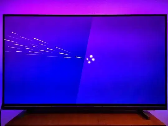

but according to edid-decode, the TV supports max. 297 MHz. I am not sure if this is true, either. When I try to set this mode, it kind of works: the TV reports 3840x2160p60 with 4:2:0 colors, but the image is shifted vertically, i.e. a small band at the top is cut off and instead shown at the bottom, see picture below: at the bottom, the white mouse cursor is barely visible, even though it should be at the top. This weird wrapping does not occur when I set the mode to 3840x2160 at 30 Hz, in this case the picture is displayed correctly.

vertically shifted image

Problem solved: The issue was not the device connected to the TV, but the TV itself (Philips 50PUS7805/12). It was running an outdated firmware that did not support 4k60, even though this feature was advertised at launch. After installing the firmware update v.201.003.243.001 from here, and enabling the corresponding option for port "HDMI 3" (only this one supports 4k60), it worked flawlessly, without any workarounds.
