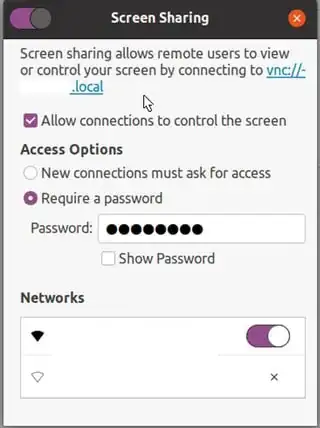

EDIT: I found PC3 had Settings -> Sharing -> Screen Sharing -> Networks -> <Current SSID> enabled, and PC1 had it disabled. Enabling it in PC1 was perhaps needed and I did it, but that didn't solve the problem.
