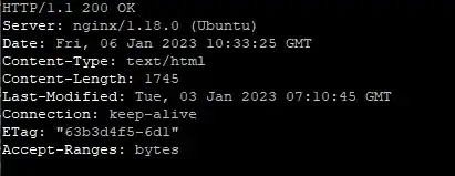

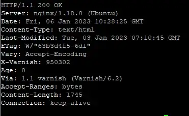

I need some help in configuration of Varnish Cache, Nginx, & SSL on virtual hosts. I am able to configure the Varnish & Nginx on the server IP (Default virtual host). When I access site at http I am able to see curl -I http://example.com enter image description here
But when use same domain with SSL ( curl -I https://example.xom ) I get this
