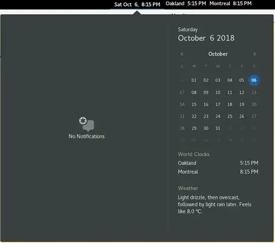

As of 18.04 LTS. It looks like this:

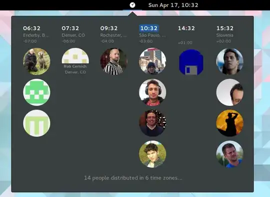

Timezone is a beautiful GNOME extension to see people with their timezones. For more info see the Github page.
screenshot
  1. Install the extension (when your GNOME Shell is ready for it)
  2. Create a text-file with the name people.json (*example code see below)
  3. Place the file where you like.
  4. Edit the settings of the extensions in Ubuntu Tweak or directly on the extension-page when you have the Firefox Gnome extension add-on and set where the json-file is placed, e.g. file:///home/USERNAME/people.json.
  5. Logout & login or Alt-F2 with command r (or maybe a restart is needed)
