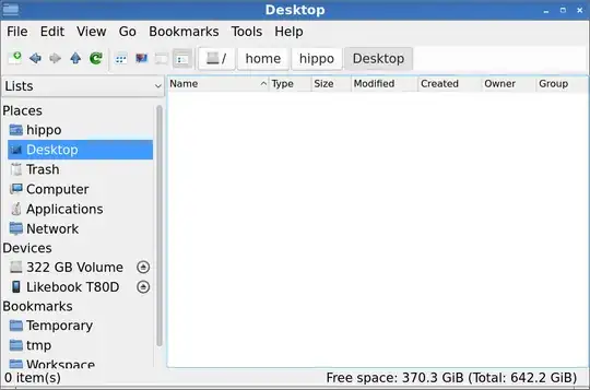

I have a Likebook Mars e-reader. When I plug it into my laptop with a USB cable, it appears in PCManFM-Qt, and I can access the files on it graphically from there:
A screenshot of PCManFM-Qt with "Likebook T80D" in the sidebar
That works okay. What I want to do is browse, read, and write files on the command line with cd, ls, cp, etc. But the e-reader doesn't seem to be reachable via anywhere I can cd to in the real filesystem (even if I've already looked at some of the files in PCManFM-Qt, which in other cases seems to be necessary). Having looked at the question How to access a usb flash drive from the terminal?, I tried lsblk, but the e-reader doesn't seem to be listed:
