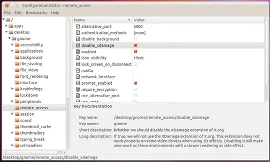

Sounds like you have compiz enabled on your desktop which is what's causing the lack of screen refresh. There's an option you can enable on the server side (in your case the desktop) - that is, the machine you wish to control, which will fix this.
ALT+F2 -> gconf-editor -> Run
Navigate to /desktop/gnome/remote_access Tick the box next to disable_xdamage Reconnect to the desktop via VNC and it should refresh the screen fine.

for 12.04 it's now in dconf-editor->desktop->gnome->remote-access->disable-xdamage
greebo52
Unfortunately this no longer works in ubuntu 12.04 The specified option is no longer available in gconf-editor.
