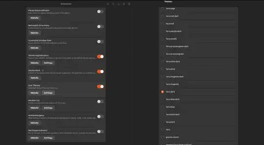

I also tried changing the settings in the Tweaks application, but it still didn't work. Later I changed the theme in User Themes by enabling User Themes in Extensions (or Extension Manager) and took the dark theme of my default theme (in my case it's Yaru-dark).

None of the above worked for me. What did work in the end (assuming of course your settings everywhere show a dark theme as selected) was pressing Alt+F2 and then typing r, this refreshes all windows.
