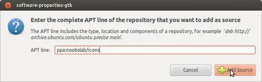

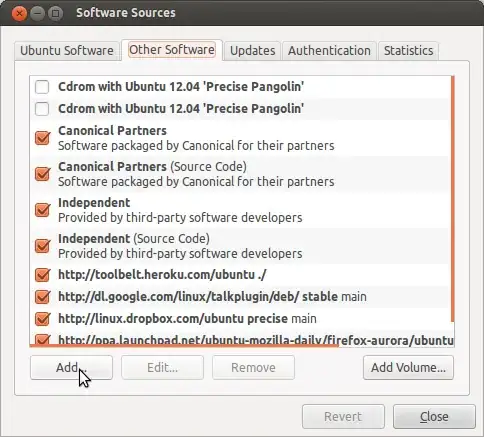

You can still add PPA through Synaptic Package Manager.
  1. Open Synaptic Package Manager.
    Step-1
  2. Go to Settings > Repositories > Other Software > Add
    Step-2
  3. Now add the PPA
    Step 3
  4. Reload to apply changes.
