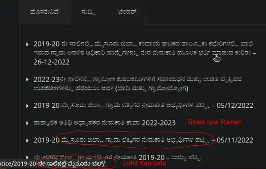

The Arial Unicode font is used to capture any font not installed on the system. And this method works for Devanagari and Gujarati, but the Kannada script is always rendered by Arial Unicode instead of Lohit Kannada. I have the Lohit Kannada installed on my system /usr/share/fonts/truetype/lohit-kannada/Lohit-Kannada.ttf
System: Ubuntu 22.04 on GNOME 42.5.
Visiting this website renders Kannada font in Arial Unicode despite providing <match> for it in the file, whereas this website renders Gujarati in Lohit Gujarati (on removing the <match> tag for Gujarati, it is rendered by fallback font for Gujarati)

I suspect that you run Firefox under some other locale (more specifically the LC_CTYPE locale category) but kn_IN, and if that is the case, the first language guarded part of your fontconfig file does not make a difference.
Please try the following:
  • Close Firefox
  • Press Alt+F2 and restart Firefox with this command:
    env LC_CTYPE=kn_IN firefox
Hopefully webpages with Kannada script look better now.
