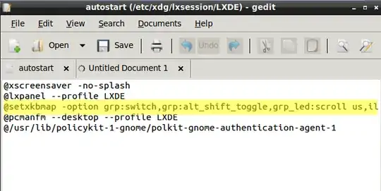

To make the change permanent, just press Ctrl+Alt+T on your keyboard to open Terminal. When it opens, run the command below:
gksudo gedit /etc/xdg/lxsession/LXDE/autostart
Enter your password, and click OK. Once the file open up, add the lone as shown in the image below. Once done save and exit.

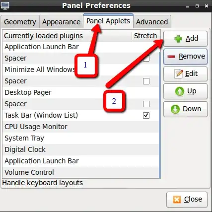

Right click on the panel, and click on Panel Settings as shown below.
When it opens, click on Panel Applets, and then click on Add as shown below.

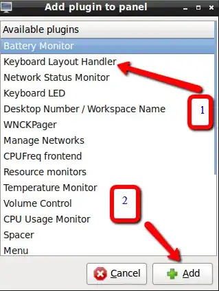

Choose Keyboard Layout Handler, and then click on Add as shown below.

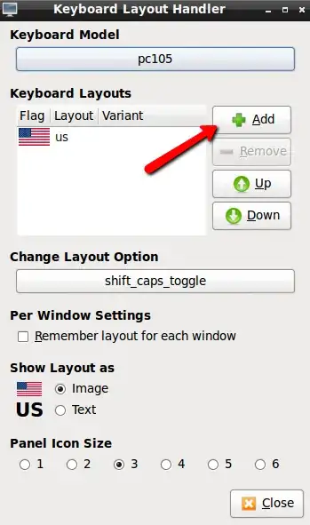

Then high-lite Keyboard Layout Handler, and click on Edit as shown below.
and then click on add, as shown below.

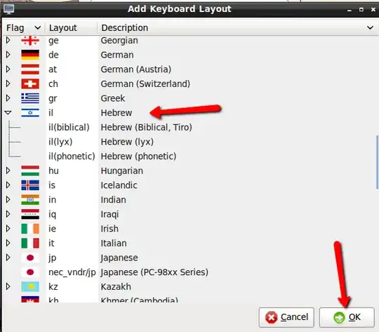

Once it opens choose Hebrew, or any other language you desire, and click OK as shown below.
