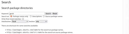

.deb files from the official Ubuntu repositories of all currently supported versions of Ubuntu can be found at the Ubuntu Packages Search website. Search for the package name, select a distribution of Ubuntu from the Distribution: dropdown menu and click the Search button.
This brings up a package page specific to your distribution, which in this case is focal. Click the focal link.
This brings up a new webpage. Scroll down a bit and click the amd64 link. This brings up a new webpage with download mirrors to download the package. Copy the link from a download mirror. I always select the first mirror which is "mirrors.kernel.org/ubuntu". Then change directories to your build directory and download the .deb file using wget.
Don't immediately install the .deb file that you downloaded without simulating the installation first with a command of the form apt install --simulate ./package1.deb ./package2.deb ./package3.deb without using sudo . This command will not install anything. It will test for broken packages and unmet dependencies. If there are unmet dependency packages, download them by following the instructions in the preceding two paragraphs and continue iteratively until the apt install --simulate command runs successfully without an error.
