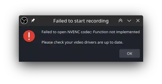

Maybe then I can get rid of this error popup in OBS, AND still have a useful rig:

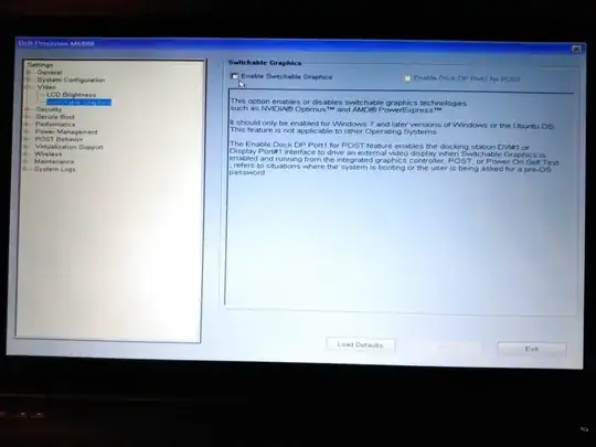

Turns out that the BIOS has an effect. Who knew?
Anyway, thanks to this answer, I got the laptop screen to work with the newer driver! My BIOS isn't labeled as clearly, but this is the setting:
Check that box, Apply, and Exit. Then the laptop screen works with the 470 driver.
After all that, xrandr says that the laptop screen has been renamed from DP-4 to eDP-1-1. So I also had to update a script that keeps the touchscreen aligned correctly.
