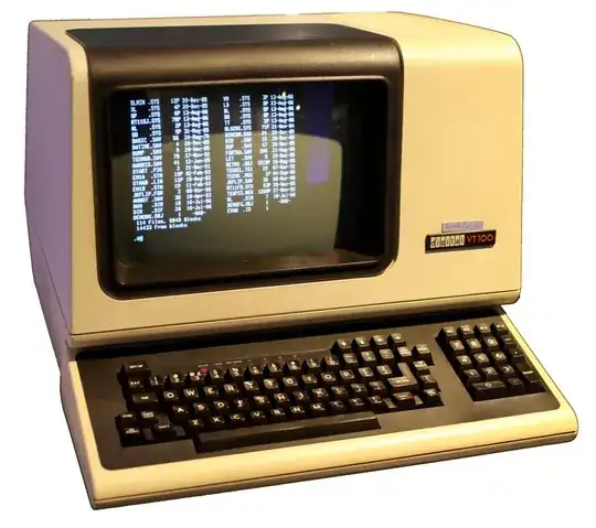

Linux, (and Unix in general), was originally a server operating system. Servers would have one or multiple administrators and several regular users, usually hundreds+, who can connect remotely via terminals like this one:
