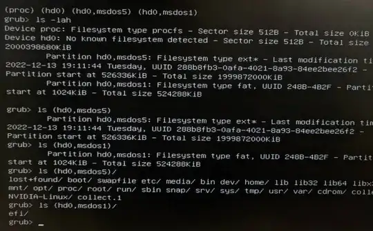

I know it used to have windows but unsure it currently still has it. I know it us running Ubuntu 20.04 but to boot into it I need to type exit twice in grub.

In grub this is what I can see:
ubuntu grub menu
I don't fully undertsand why I need to type exit in grub , but my hunch is maybe there are two version of Ubuntu installed and the current config doesn't explicity boot into one ? (It doesn't list the typical OS select screen though).
How can configure grub so the machine boots into Ubuntu 20.04 on it's own, without me typing exit twice ?
