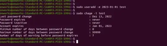

You can create a temporary user with the help of useradd command and --expiredate option (expiry date) that is disabled/expired after a certain period of time.
sudo useradd -e <date> username  # or
sudo useradd --expiredate <date> username
Suppose you want to create a user test and set the expiry time to '01 January 2023'.
sudo useradd -e 2023-01-01 test
You can then verify the expiry date etc
sudo chage -l test
Hope this helps.
