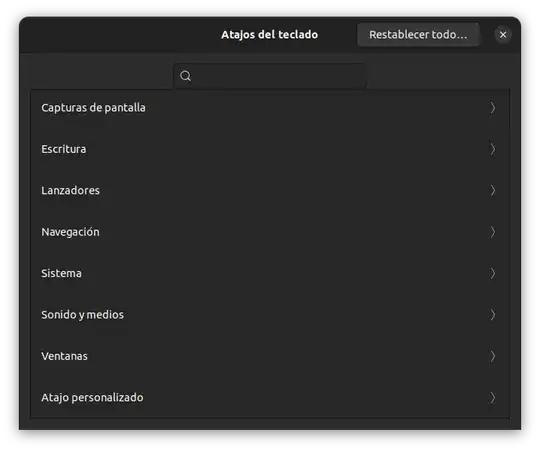

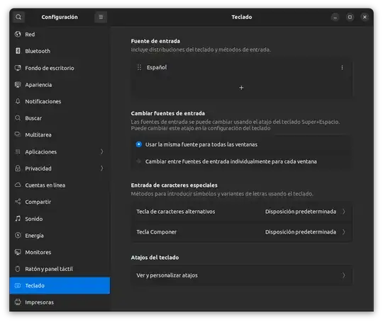

#1: Open Settings and go to Keyboard enter image description here

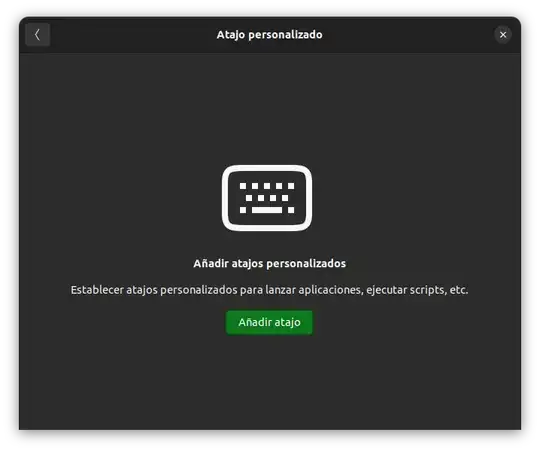

#2: Click on Keyboard shortcuts (it should be the option at the bottom)enter image description here and then scroll down until you see Custom shortcut (again, the option at the bottom), click it.
#3: Click add and name it, the command is reboot, set your desired shortcut such as Ctrl + Alt + Delete.enter image description here enter image description here
WARNING: CTRL+ALT+DELETE is already set for log out. If you use that shortcut then log out will not work unless you change it to something else.
