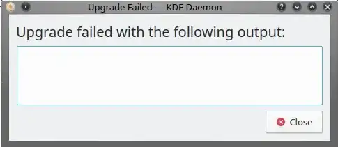

Upgrade to Ubuntu 22.04.1 LTS failed with a e empty error message.
what happened
As message popped up to upgrade to Ubuntu 22.04.1 LTS
Upgrade available to Ubuntu 22.04.1 LTS
there i pressed the button Upgrade and got this message ( Upgrade failed with the following output: )

So how i could install all available updates for your release before upgrading without errors?
Any idea?

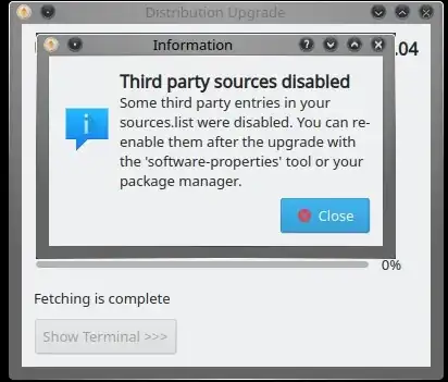

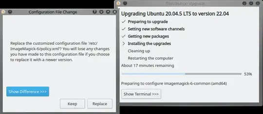

have video chat(jitsi), wrote emails(webmail), played an open source game(0ad), took a walk, was sleeping(Sat to Son). I woke up and when I switched on the computer I immediately clicked on upgrade again (this time it went through without an error message, without interruption).
i pressed replace config of ImageMagick
restart system
the time taken was: 32 Minutes (11:39 - 11:07 at Sunday 11th Dec. 2022 )
