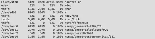

My /dev/sdb2 partition used up all it's space but the Used number is less than total Size of the partition in large number. I don't know what is happening.
How to check where was my missing 30Gb? enter image description here

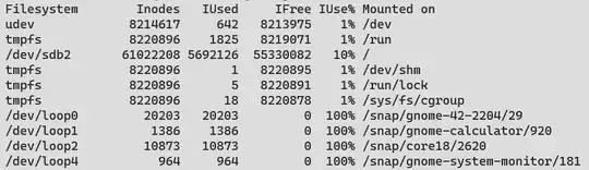

Here is my inode table enter image description here

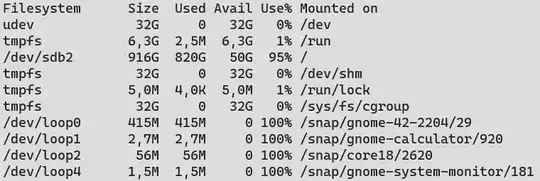

As @Nmath mentioned in the comment: A variation of ± 5% is pretty normal. You're at around 3%.
After removing some used space, the amount of Avail disk increased and everything was back to normal
