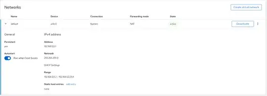

Then I create a KVM VM with two network attached (one for the br0 and the other is NAT based bridge)
And from the VM, I configure the netplan to be like this: cat /etc/netplan/00-installer-config.yaml/:

Here the VM use enp1s0 for the static Public IP (xxx.xxx.198.104) and enp7s0 for the NAT from hosts (192.168.122.xxx).
From VM ip a command, it shown that the VM get correct IP.

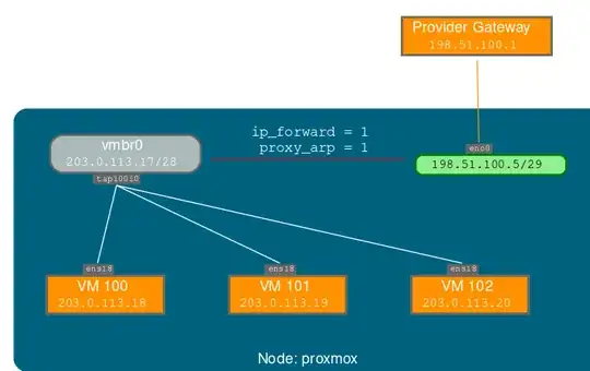

I contacted the DC provider, they have documentation to add Public IP to VM here https://docs.ovh.com/gb/en/dedicated/network-bridging/ but only applicable if I use Proxmox as the host. I need to create a bridge network with the specified Mac Address attached to that bridge, then from VM we need to apply the Public IP.
How to do that on Ubuntu?
Update 2
I managed to create the bridge network with my Public IP on the hosts side with the following command:

I read Proxmox configuration reference here (https://pve.proxmox.com/wiki/Network_Configuration) and I tried to implement the Routed configuration on the Hosts.
Thus, I installed ifupdown packages, and create configuration below:
auto lo
iface lo inet loopback
auto eno0 iface eno0 inet static address xxx.xxx.51.20/24 gateway xxx.xxx.51.254 post-up echo 1 > /proc/sys/net/ipv4/ip_forward post-up echo 1 > /proc/sys/net/ipv4/conf/eno0/proxy_arp
auto vmbr0 iface vmbr0 inet static address xxx.xxx.198.104/24 bridge-ports none bridge-stp off bridge-fd 0
auto vmbr1 iface vmbr1 inet static address xxx.xxx.198.105/24 bridge-ports none bridge-stp off bridge-fd 0
auto vmbr2 iface vmbr2 inet static address xxx.xxx.198.106/24 bridge-ports none bridge-stp off bridge-fd 0
auto vmbr3 iface vmbr3 inet static address xxx.xxx.198.107/24 bridge-ports none bridge-stp off bridge-fd 0

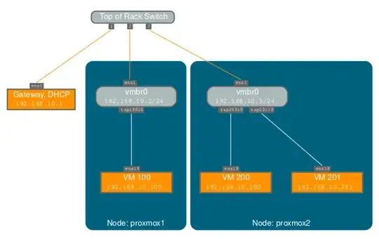

1. Default Bridge
Default bridge means that the VM worked like they have direct attachment to the network.
Default Bridge
In my cases, after careful cross check with the legacy ifupdown configuration and ip link add commands, I found that in OVH dedicated server environment (not the eco one), we are allowed to have default bridge with pre-defined MAC address.
If you use legacy ifupdown:
Network configuration for hosts is like this:
auto lo
iface eno1 inet manual
auto vmbr0 iface vmbr0 inet static address xxx.xxx.51.20/24 gateway xxx.xxx.51.1 bridge-ports eno1 bridge-stp off bridge-fd 0
Then run:
sudo systemctl restart networking
As you can see, the dedicated IP address for the host is included in the bridge configuration.
And for VM/client configuration, it's same with the documented here.

2. Routed Bridge
Most hosting providers do not support the default bridge network. For security reasons, they disable networking as soon as they detect multiple MAC addresses on a single interface.
Some providers allow you to register additional MACs through their management interface. This avoids the problem, but can be clumsy to configure because you need to register a MAC for each of your VMs. You can avoid the problem by “routing” all traffic via a single interface. This makes sure that all network packets use the same MAC address.
Routed Network
auto lo
auto eno1 iface eno1 inet static address xxx.xxx.51.20/24 gateway xxx.xxx.51.1 post-up echo 1 > /proc/sys/net/ipv4/ip_forward post-up echo 1 > /proc/sys/net/ipv4/conf/eno1/proxy_arp

3. Using NAT bridge:
The default bridge that comes with libvirt installation is a NAT based bridge, so it should be working by default.
In this case, what should we do is to make sure the hosts know that it have more than 1 Public IP attached. So:
$ cat /etc/netplan/50-cloud-init.yaml
# This file is generated from information provided by the datasource.  Changes
# to it will not persist across an instance reboot.  To disable cloud-init's
# network configuration capabilities, write a file
# /etc/cloud/cloud.cfg.d/99-disable-network-config.cfg with the following:
# network: {config: disabled}
network:
    version: 2
    ethernets:
        eno1:
            dhcp4: true
            addresses:
            - xxx.xxx.50.20/32
            - xxx.xxx.198.104/32
            - xxx.xxx.198.105/32
            - xxx.xxx.198.106/32
            - xxx.xxx.198.107/32
            match:
                macaddress: a4:bf:01:2a:19:d0
            set-name: eno1
Then, assume that the VM already got a static IP (eg: 192.168.1.10), then we only need to forward the connection to that IP as described in @dummyuser answer:
iptables -A FORARD -d xxx.xxx.198.104/32 -p tcp -m tcp -j DNAT --to-destination 192.168.1.10
