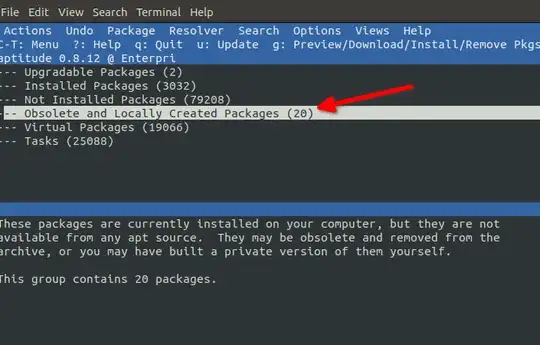

aptitude gives you this functionality
Highlight the line and press enter to see the list of packages.
It will show all packages you installed from .debs that are not found in any repos, as well as any packages left from removed repos.
Andrew Lowther left a useful comment giving the one-liner version using aptitude:
aptitude search '?obsolete'

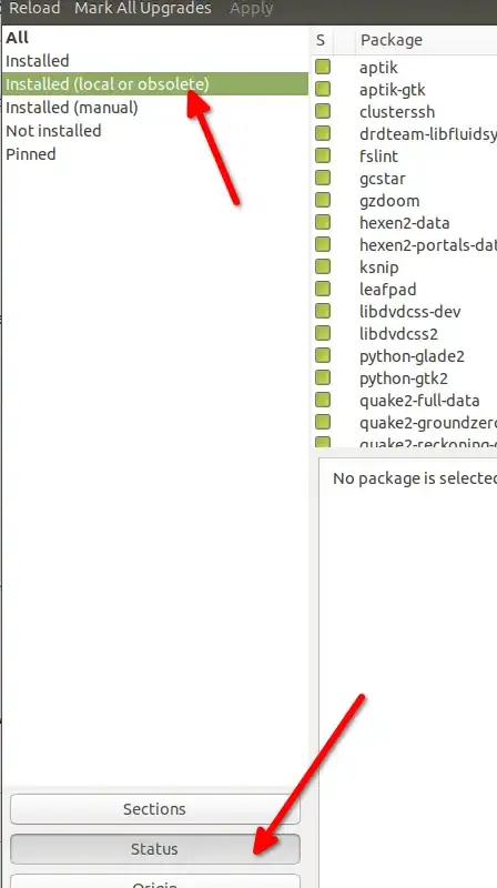

If you want a GUI app, Synaptic Package Manager has the same functionality. Select Status at the bottom and look in the Installed (local or obsolete) category.
