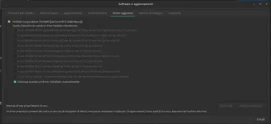

I have a nvidia card, so I need its driver
In the image attached, it is shown as I can't select any nvidia proprietary driver version other than the one that is already installed
Is this because I removed snap ?
Do I need it back in order to be able to select a more apt nvidia driver version ?
Also, this is in the terminal

You can try to install them either through Additional drivers in Software & Updates or via the command line with the ubuntu-drivers command. I suggest to pick the one recommended by the system given by the command $ ubuntu-drivers devices
